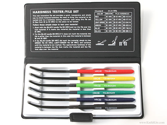

Во еще каку девайсину нашел -
http://www.knifekits.com/vcom/product_i ... cts_id=954
Hardness Tester Files - SPI - (6pc Set)
Price: $124.95
High quality industrial hardness test files. This kit is a must for heat treating and quality testing blade steel materials.
* Includes the following files:
HRC 40 File
HRC 45 File
HRC 50 File
HRC 55 File
HRC 60 File
HRC 65 File
